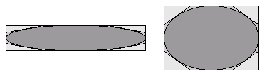

Carving a curved surface from a rectangular piece of wood, such as a two-by-four, is done by making successive approximations of the final shape. Using guidelines drawn on the wood, you will cut out a blank that, in section, has four corners and sides. You will then draw additional guidelines on the blank and cut away the corners between them to create, in section, a shape with eight corners and sides. This is as far as the guidelines in Fig. 7 will take you. After that, you are on your own as you cut away the eight corners to make 16, then the 16 corners to make 32, and so forth.
Approximating the shape within
Fig. 4. Approximating the shape within.
It might help when shaping the paddle to imagine that there is a shape inside that you are trying to free. The guidelines in step 4 of Fig. 7 are designed to create facets on the blank that touch the curved surface of the hidden shape in approximately the center of each facet (see Fig. 4). As you create additional facets, try to follow the same principle. Don’t be mechanistic about it, however, for the form underlying the facets is rarely symmetrical. Look at the sections at the bottom of Fig. 7 to see how the shape changes between the loom and the tip of the blade, and use touch and sight to create an organic shape that flows together and looks and feels right to you.

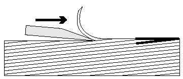

Go with the grain
When carving wood, always cut with the grain; otherwise, you are likely to gouge the wood. To see what is meant by cutting with the grain, look at Fig. 5. Note that the grain of the wood meets the surface that is being shaped at an acute angle. Viewed from the side, the surface of the wood and the wood grain make a series of wedges that point in the direction you should cut (heavy lines in Fig. 5). If you cut against the grain, as in Fig. 6, your blade will try to follow the grain into the wood. Even if the blade cannot go far into the wood because it is held in a plane or a spoke shave, it may still tear the wood rather than cut it.
Cutting with the grain
Fig. 5. Cutting with the grain.
Cutting against the grain
Fig. 6. Cutting against the grain.
