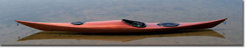

After glassing the exterior, I toted the kayak to the backyard for my first wide-angle view of the result.  Despite some construction snafus, I'm pleased with the outcome.  I really like the proportions of this one.
