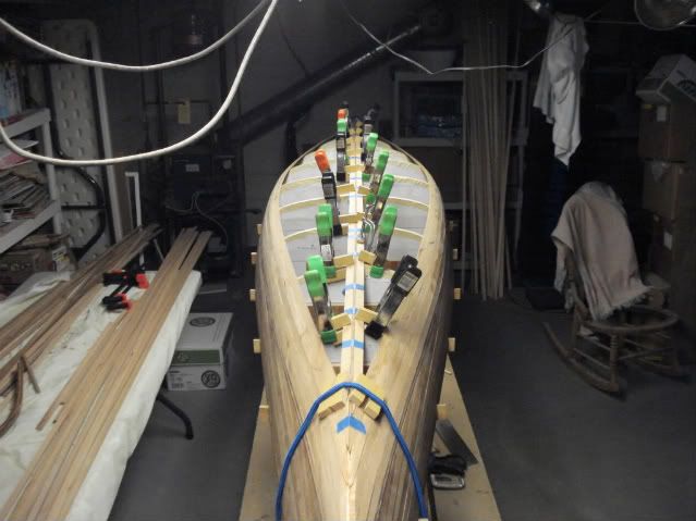

I finally got my next build off to an official start. It is a KF design for day use on lakes.

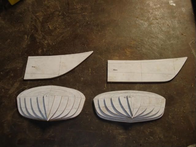

These forms are for a 1/4 scale model of the same design I want to build just for fun.

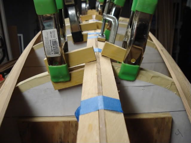

The inner stem is pine and the outer is two strips of walnut with a strip of ash between.
Ready for the first strip. Sure wish I had some.

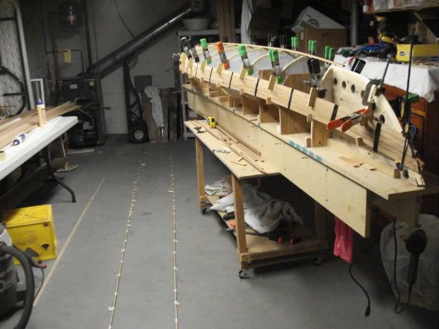

After two weeks of rain and snow the weather cooperated this weekend. The sun came out and temps were in the high 50's so I was able to move my saw outside and cut all of my strips. I got my western red cedar from a new source this time. The cost was more tha $1 les per lf but the selection was limited and there was a lot of color variation between boards, some dark some very light.

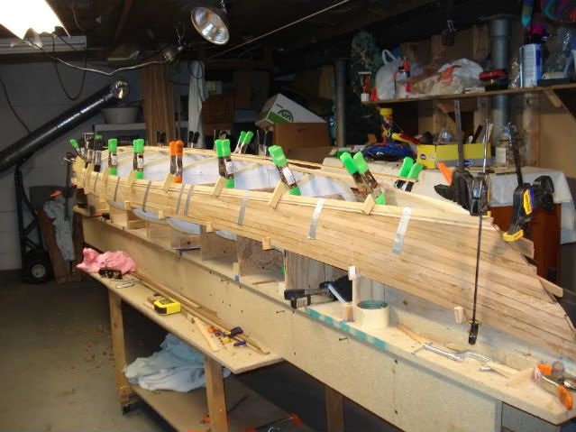

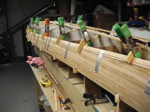

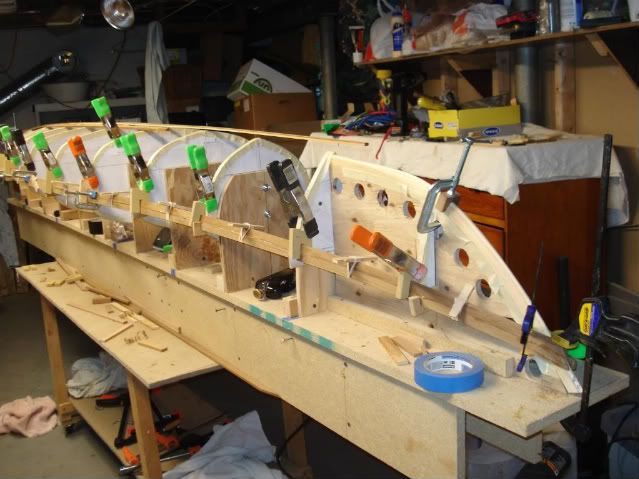

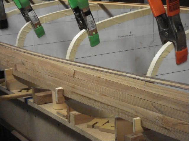

Got the first strips on today.
Clamps, tape, rubber bands .... Whatever gets the job done.

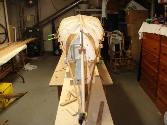

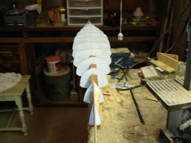

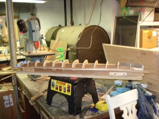

The mini strongback for the 1/4 scale model.

Are you building the model and the kayak at the same time? looks good so far, the color variation justs puts forth the challenge to do something creative with it.

I am building the model at the same time. When you build without staples you spend a lot of time waiting for glue to dry. I thought it would be fun to try a model too.

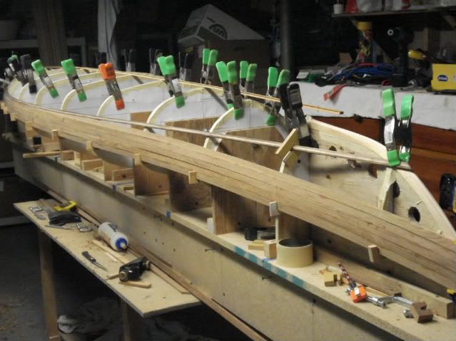

Been making some slow and steady progress. Since I only ended up with a few dark WRC strips I started with these at the shear and stripped up to the water line. I created a couple of feature strips from some thin strips of walnut and ash.
I positioned them along the water line and cut away the overlap.
Glued in place
Filled in the ends with dark strips and started the hull below the water line with the lighter WRC strips. You can see the color variation here.
"If you can dream it, you can do it." - Walt Disney

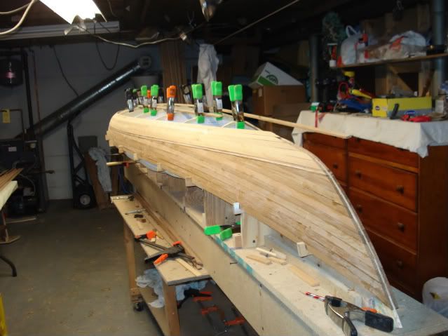

Stripped up over the chines and added a strip along the keel line. I used a thin strip of dark WRC sandwiched between two light strips.

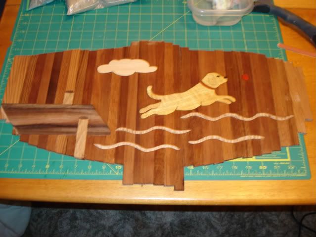

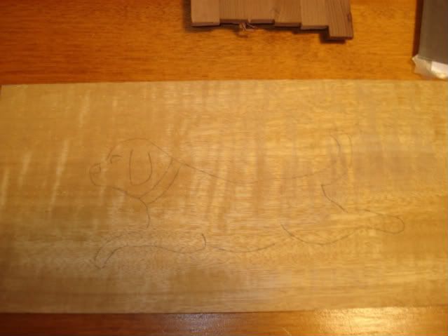

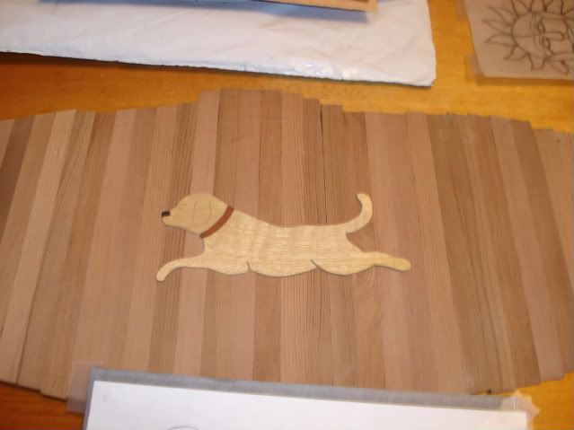

I had some ideas for using veneer onlays on the deck this time. I bought a variety pack and have been having some fun practicing on a panel I thought I would use for the rear bulkhead.
Wet down to see what it will look like. Going to try to get a layer of glass on it tonight or tomorrow.

Love the onlay, Nancy! I also like the model... I decided to build a 1/2 scale model of a rescue boat design I posted in the kayak foundry forum, and it's most informative to do so. I'm finding a few things that sof won't allow me to do easily, and other things that I thought would be a problem aren't.
