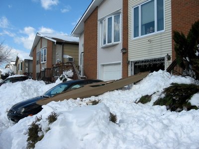

I've been a bit lazy this year, with the sewing and researching the hull finish material, which will be Grizzly Grip truck bed liner, since it is available in 24 colors.
this isn't exactly the type of white water I had in mind when I started the WW design, even though it IS white (for now) and it is basically water. I think I have a few days left to finish it before launch time, though.

That was technically a 24" snowfall, with blizzrd conditions, which means some very interesting drifts... we had 34" on our front porch, jamming the front door, so I had to open the garage door so I could shovel my way out to the street... that horrendous mound is the car, with a 36" drift on top :shock:
