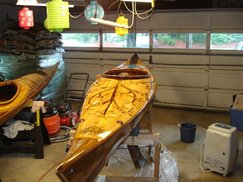

Looks about ready to get wet Nancy?

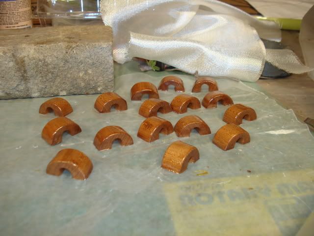

Soon Bill. Took her outside last weekend to start sanding and got rained out. Ironically it has been too hot here this week for that so I have been working on some of the finishing touches. The hatches fit better after heating them but not as well as I would like. I didn't want to resort to straps so I made some toggles out of some scrap cherry. In keeping with the tree motif I made them leaf shaped. They seem to work well.
I decided not to use the recessed deck fittings on this build. It seemed too disruptive to the deck design to cut those big holes in the deck. I made some pad eyes out of the same scraps of cherry I used for the toggles.
I will glue them on after I sand the deck smooth.

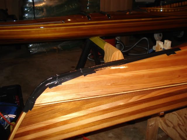

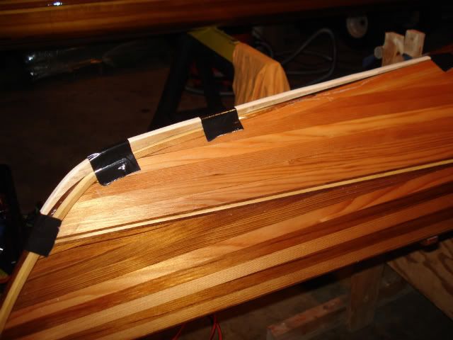

Thanks Scott. Looks great so far. Still not completely finished with mine yet. I got the fittings for the decklines on and 1 coat of varnish and then decided to try to inprove the tracking. I cut a small wedge out of a piece of scrap and duck taped it to the rear stem. It made a big difference. I paddled it all summer like this and was very happy with the results. I plan to add a permanent hardwood piece before next summer. I am currently working on a solo canoe I plan to give to my brother. When I start the fiberglassing on that project I will glass on the wedge.
