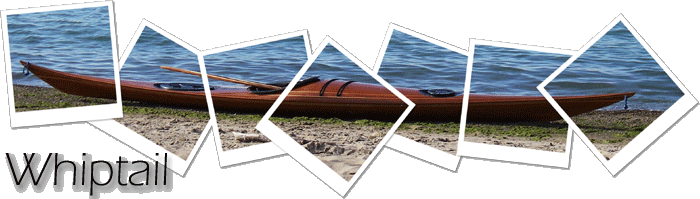

Whiptail designThe Whiptail is my latest design - a wood strip interpretation of a traditional Greenland-style kayak.  Its low volume, low aft deck, flared sides, and raked stems attest to its Greenland heritage.  The fine entry lines, low wetted surface area, and low predicted drag combine to produce an hull that comfortably paddled in the 4 - 4.5  knot range .  The 18' x 21" Whiptail is designed to be a day-paddler with low windage and easy rolling characteristics.
While it is a sleek, low-volume kayak, it is designed to accommodate a larger paddler (up to 250 lbs).
Characteristics:
  • The flared sides provide reserve buoyancy
  • The sloping cockpit opening and high foredeck make for easy entry and exit, even with the ocean-style cockpit.
  • The slightly fish-form sheerline and the full foredeck cross section maximizes foot and leg room
  • The low profile reduces windage.

After glassing the exterior, I toted the kayak to the backyard for my first wide-angle view of the result.  Despite some construction snafus, I'm pleased with the outcome.  I really like the proportions of this one.
